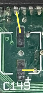

I have a Performa 475 logic board that I am re-capping. First time working with surface mount components and you guessed it, I ripped off a few pads. I swear I wasn't using the "twist" method 😄 but 4 pads ripped off anyway.
So I need to run some bodge wires I suppose but I don't know where from. Here are the missing pads:
C149Both + and - pads

Maybe I have refined my technique, but I've probably recapped 3 or 4 dozen 'boards during the COVID years and only ripped off a 1/2 dozen or so pads using the 'twist-method'... When I do need to repair these, I use a short piece of wire-wrap wire to go from the trace to under the cap pad.
Post some pics of the damaged area and I'm sure the community can help you figure out where the repairs need to connect to.
Can't see C101 in your photos.
C128 - probably goes to the other side of the board but I would need to check my 475 to be sure.
You have more to worry about than missing pads though - that board is very dirty, especially around the DFAC area.

My friend helped me with soldering the bodge wire to the chip for C149. He couldn't solder to the dot (what is its proper name?) to the right of the missing solder pad (more on that) so he soldered to the positive of C150. Is that correct? Visually it looks correct to me, but positive to positive doesn't seem right. Back to the "dot". He didn't want to scrape. I think I "dirtied" it in my prior attempts and should be able to scrape/expose it.
