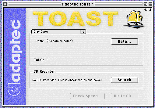

I first tried burning directly in disk utility- no luck. Then I found out about toast, so I installed 5.2.3. I was able to select “bootable” there, thinking that would work, but nope. I have tried “write session” and “write cd” options, doesn’t make a difference. All my old laptops will read the burned discs just fine, they just won’t boot from them.

That might help with making an image - note you are possibly using the wrong options in toast if it offers you "bootable" as an option (weirdly)...
Once you have the image, burn the image using the Disc Image option in Toast, not disk or volume.

Well, here’s one way that works (as long as you have a good CD to start with). Using the copy command in Toast 5, I was able to make a bootable disc. Unfortunately I’m still unsuccessful at burning my own image or an image of a disc, but I guess that’s a problem for another time. One of these days I’ll get 9.2.2 on my titanium PowerBook. The amount of OS 9 bootable machines I have with a CD burner is very slim!
