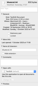

Daft question, but just looking at your images, and not knowing the product at all, but the file looks like it is called "bluescsi" instead of "bluescsi.ini"?
I know it doesnt show in finder (I don't know why) but when you go get info it does show full extension.
Cheers
AP

I installed my pico w during the week-end on my 475 and all went well.
Did you upgraded the bluescsi firmware to get access to wifi beta support ?
This is the first thing you have to do. The wifi support is only in this beta release.
Then you should have some more lines in your log file.

The stock firmware does not support WiFi yet. AFAIK, you have to install a different firmware which is in beta right now.
FYI, I did use the "USB method" to do the firmware upgrade. I have read that some people had pb with the SD card method.
USB method is very very easy ...
