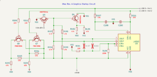

I populated one of my Whisper cards as attached, but I could not get it to work properly. Now, with the card installed, the Mac starts up as soon as the power lead is plugged in. If I switch it off with the front panel button, it just starts up again.
I think the issue will be in the R139/R140/R141 area, as this is the part on the G4 I looked at that differed and I had to make some guesses as to the values of the components. I now want to look at a Bondi Blue iMac logic board and see if it can give me any more clues.
Can anyone tell me what the function of this circuit is? I know it’s for the keyboard startup function, but what’s the comparator for etc? Just curious.

I've been studying the circuit in detail and reading up about comparators and voltage dividers, and now understand the principle better. I measured the voltages on the comparator on my G4 and fed them into ChatGPT along with my schematic. It has given me some new values to try for the unknown resistors which provide the reference voltage.
R141: 4.7kΩ (as before)
R139: 470Ω
ChatGPT values were correct?! That’s awesome!
It picked the right values for the voltage divider but got the two resistors the wrong way around. It's definitely not perfect, but it helped me push this over the line 100%.
So I now have a Beige G3 with a USB keyboard that starts up the machine when the power key is pressed.
I wonder how much that prototype is worth now...
Yay! Excellent job! What a fun use for ChatGPT. I wonder how similar that circuit is on the G3 Blue and White. I have a couple of those motherboards laying around and might be able to check.

It's kind of funny that C77 is populated on the card all by itself. I wonder if they forgot to mark it as do not place...or maybe if it's a decoupling cap it still serves a small purpose for other nearby components or something.
Definitely! It’s very cool that when I uploaded the schematic it knew it was a startup circuit — it’s a standard layout, apparently. I learned a lot from its explanations.
I studied the one from the G4 Yikes - the B/W should be the same, or similar?

On the G4 Yikes [as compared to the Beige G3] the reference voltage of 0.26V going into 1IN+ is generated differently, and there is an additional connection from 2OUT. It seems odd to me, on the G4, that 2OUT is part of the circuit when 2IN- and 2IN+ are both n/c. LM393 is a dual comparator but only one half of it is apparently used.

Here's the iMac G3 Rev. A USB keyboard startup circuit. It's just like the Beige G3 except that it uses both sides of the comparator as it has dual USB ports. I'd expect the Bordeaux card to do something similar, @dougg3 .
I must take a look at the G4 PCI Graphics layout again, as I've labelled 2IN- and 2IN+ as being not connected, but as it also has dual ports (and 2OUT is wired up) they must be connected to something...
Nice! Thanks, that's very helpful! I will definitely take a look when I have a chance.
