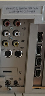

I somehow just today discovered that for the past decade, I've had a Beige G3 Desktop that came from the factory with a DVD drive, and indeed it has a Bordeaux card inside. With the knowledge that I actually have one here in front of me and I also have a multimeter and know how to use it, is there anything I can do on my end to help complete your notes so we have a BOM for adding the USB ports to Bordeaux cards?
Is it rare enough that it would be a sin to modify it? :D
