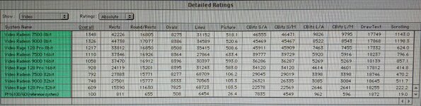

Acceleration comparison (2D QuickDraw only) between some various ATI cards in OS9. 6100 for reference.
Yes the 9000 isn't much faster than a Rage 128, but increases in 2D performance plateaued as 3D performance became the poster child. It does show however that it is accelerated, and pretty fast.
