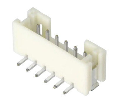

I ordered from the Mouser cart (thank you Joopmac) except that J11 and J12 headers are backordered and not in stock. I am guessing this header may work found on Amazon...

Oops! I forgot to add those connectors to the BOM. Here's a picture of the back. They are 2 mm pitch through-hole JST connectors, like these on Amazon (the link you provided doesn't seem to be working).
I actually bought the ones I used from Ali Express

Addendum for the mouser cart:
correct JST headers
*The header in my first cart was wrong; SMD and not through hole (the wrong ones are not in stock so probably one does not have these yet)
correct JST connectors
the pins

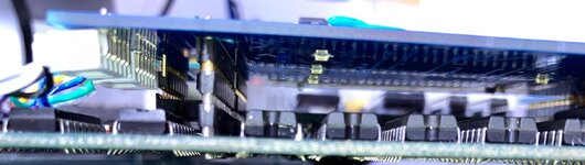

I have all the components installed on the board. I just need to start adding the headers.
I should be able to mount the PCB to the motherboard early next week.

Test fit. Very nice fitment!
I just need to place headers on the board and then run jumper wires.
