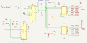

Here is the first version of the auxiliary board (512 cycles mod).
It connects to a socket mounted on top of U4F (Piggy Back) and to strip pin sockets that replace the RP2 and RP3 resistor arrays.
JP1 & JP2 select between system RA0 & RA8 (proven to work with the selected RAM ICs for the expansion board), and modded RA0 & RA8, which are generated like in the Mac Plus. Golden Potato figured out how to generate the missing RA8 (DMA active) that comes from BMU2 on the MacPlus.

One thing I spotted is pin 1 on the aux board’s ‘253 should be connected to DMA instead of ~DMA. I think the ~DMA signal is also accidentally connected to a signal used as a pull up for a bunch of other inputs. Other than that, it looks good to me!

The 1024 cycle mod only benefits DRAM ICs which have 10 address lines (RA0-RA9). The CAS generation for that density of DRAM must create only 4 CAS lines by multiplexing the 2 system CAS lines with A21. I’m on vacation right now, so I can’t dive in too deep, but I’m betting some jumpers could be added to modify the 16 CAS line generation circuit to only output 4 CAS lines by ignoring A19 & A20 right at the demux ICs, and the other CAS lines would never become selected.
If you were trying to make one aux board flexible for either DRAM density: in addition to the CAS generation changes, you would also need to generate both RA9 signals (one driven by DMA, the other driven by ~DMA) as well as mess with RA1 generation.
Thank you so much for catching that! I really appreciate your keen eye. The pin 1 connection has been corrected to DMA. It looks like we had a bit of a mix-up there. Your feedback is invaluable.
Here is the multi-purpose aux board that gives the flexibility to choose the RAM refresh mode. ("Magic" Refresh, Mac Plus Refresh, or 1024 cycles Refresh Mode). For "Magic Refresh (SYSTEM RA0 & RA8)", don't need to populate any of the 74253s, 74257, inputs from J3, or any associated components. I just ordered the PCBs for this aux board and the 3.5 RAM expansion board for 512 refresh cycles. I will post the results when I test everything
Also, please note when selecting Magic or MacPlus refresh modes, the onboard system RAM is used and controlled by ~{MCAS2F} / ~{MCAS3F}, which are generated on the 512 RC Memory Board.
