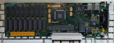

I realise I mean 16 greys instead of 256 (up from the stock 4 greys) - I'm forgetting my TPD characteristics. When I was getting 256 greys it was being driven from a 630 internal video with way more VRAM.
This is my card :
This it before being upgraded (4 shades of grey) :
Then I upgraded it (set to colours in the photo, but you should set to greys because some "colours" look the same and waste your pallette) :
This is the previous sample image again in 16 greys. 16 greys is sort of equivalent to 256 colours in how well it transitions between shades.
