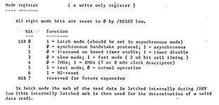

I wish I understood better what the "latch mode" bit in the IWM was for.
Apparently the latch mode bit "should" be set in async mode, but the spec sheet also says "In port operation, which is asynchronous mode true and latch mode false with /DEV held low indefinitely, read data will appear and change as if the IWM were being continually read. In port operation the MSB can be used to continually clock data into external registers. The MSB will be cleared at least six FCLK periods before being set." I can't quite understand what this means, nor what "port mode" would be used for, nor whether any Apple II or Mac ever actually used the IWM in this mode...
