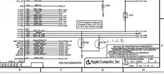

Looking at the schematic, I can see there is faint pen markup correcting the labels for the two LEDs. This markup corrects phrasing from the assumption that the 650 is a desktop at 25MHz, and the 800 is a tower at 33MHz, to just that the 650 is a desktop and the 800 is a tower.
I considered if perhaps the ROM revision changes behaviour, but looking at the schematic, this can't be the case. "LED_Pwr" is jst a test point to check that the LED is getting power, so there is no way in this circuit to detect if DS1 is fitted or not. On the other hand, a jumper included in the tower LED cable causes "CPU_ID_ext3" to be pulled down (overpowering the built in pullup) and sends a signal indicating that the tower LED is fitted... i.e. this is a Quadra 800.
In the following, "For 33MHz" and "For 25MHz" have been crossed out and an almost illegible notes written. 33MHz has been replaced with "Frigidaire", the 800 case. I can't read the other, but it probably says "Lego", the name of the 650 case.
Has anyone else seen their machine gestalt change from modifying DS1? If would only make sense if the circuit design was modified, I'm really confused by the suggestion.

Very strange. If your's behaves like that, it doesn't match the schematic. It isn't possible for that circuit to detect if DS1 is there or not. Unless Led_Pwr goes somewhere, but it doesn't go to the chip that has the rest of the model detection pins, or anywhere else I could find other than the test point. Plus it would be redundant.
Is there any chance you shorted something on J25, because it's actually purpose is to identify if it is a tower or desktop. The pin CPU_ID_ext3 is just there to tell the ROM and OS that you have a tower, it has no other purpose. Clock speed and logic board are covered by CPU_ID_ext1 and 2.

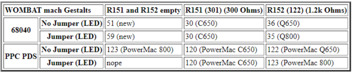

To close the loop on this thread, the pencil marking around R151 saying "delete" means R151 needs to be removed from the board to switch a Centris 650 to a Quadra 650/800. With R151 removed, then the LED jumper toggles between Q650 and Q800.
