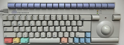

Would this be interesting?
DataDesk with integrated trackball. The two buttons above the ball are drag (mouse button held down until pressed again) and automated double-click.

DataDesk TK-3000, "Version 1"
  • Original Address:
    • Keyboard: 02
    • Mouse: 03
  • Handler ID:
    • Keyboard: 02
    • Mouse: 01
  • Change Mouse to Handler...
    • 01: yes
    • 02: no
    • 04: no

@pl212 - Does the keyboard have a model name of any kind that you know of, or just "TK-3000"?

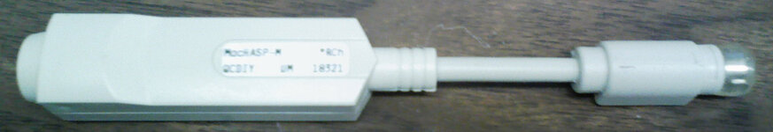

I can send you a MacHASP-M rather than submit to electronics recycling.
If you want it, send a postal address. Thx, peter at easthope d ca
If @Tashtari doesn't want or need it, I would gladly take it. I'm reversing some old mac copy protections and a MacHASP would be nice for testing and playing around.
