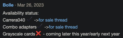

When will these be available? Ive been dying to get grayscale in my se30 to complete it!
