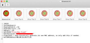

franklyn
I have a real Dayna SCSILINK and it works well with my IIsi and System 7.1 ...
When I use a BlueSCSI the Harddisk part works fine but the Network do not work.
.... where could the problem be and who can help ?
The problem is sitting in front of the screen ...
I had entered the SSID in lowercase instead of uppercase !!!
