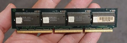

The RED ROM in the Macintosh Interactive TV is 2MB:
So 99% sure this tool could program that :). I did look into also recreating that red ROM, but so far I have not been able to track down enough of those chips in the right package to make it worth while :(.
Oh yes, I'm 100% sure that SIMM is supported by this program. It has eight Am28F020 chips. Based on the tables in my disassembly, I believe it would be programmable in all of the Quadras, including the 660AV/840AV. I'm pretty sure it would identify in the program as "AMD 28F020 x 8".

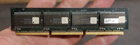

Apple appears to have also made a SIMM (well, DIMM) that uses 16 of those chips. The table entries were for early PowerPC stuff. I wonder what that one looks like...
You're right, an adapter board (and new firmware) could probably add support for Apple's SIMMs to the programmer, but I'm thinking it's probably not worth the effort versus the cool SIMM that you've been working on. Especially if I can hack this Flasher program to be compatible with it...
