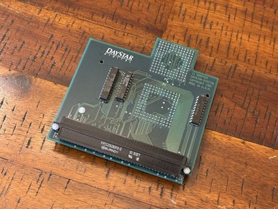

I stumbled across this on ebay today. I'm sure it doesn't work with an SE/30 normally, but I do wonder if is could be used in some janky way like with dupont wires.
The IIci cache slot is a superset of the 68030 CPU socket. In most cases you could (conceptually) hook an IIci accelerator directly to the socket with ~120 jumpers, it just isn't practical and doesn't mechanically work in the SE30.
There are other factors involved (clock frequency, clock conditioning, patch ROMs, and more) but in the simplest sense that is what is going on with the Diimo adapter (and clones such as Twinspark), or Bolle's omni-adapter. The IIx version of that socket adapter would work electrically (but not mechanically) in a SE30.
The socketed Carrera and Diimo i posted above are essentially an IIci card jammed onto a pcb with a 68030 CPU footprint, with the specific logic adapter logic and video fix in the case of the Carrera.
