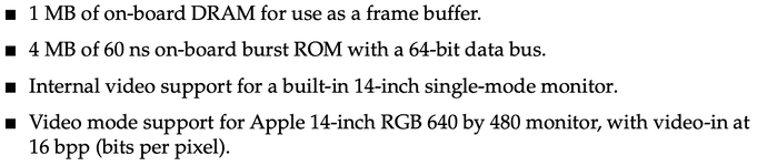

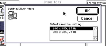

Can you shed any light on the resolutions available? Are you limited to 640x480?
I checked all over the control panel, but could not find out the screen resolution of my system. I'd be happy to do it if you tell me how to do this.
Ha, Monitors somehow was not enabled in my control panel. So the verdict is in: 640x480
It’s so weird that just that this one obscure model of the 5x00 AIOs was quietly specced as fixed frequency, when the rest of the series were multisync. Can we surmise that they were using up old monitor parts stock?
To be honest, I run my Multisync 15AV display at 640x480 most of the time, since it’s pin sharp - but loses too much definition at 800x600 and above. Most 68k software expects 640x480 anyway.
Try holding the Option key down when you select the Monitors control panel, to see additional video resolutions.
If that doesn’t work, I wonder if you have the correct Monitors control panel that matches your operating system version.
