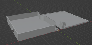

I got my PowerBook 180 now, with a weird aftermarket 1xx battery pack that was too dangerous to open. I need a 3D-printed shell, however there aren't any really good models available.
There's this one but for some reason it doesn't seem to have rails for the battery door
I sent jcs a DM last Friday asking for his PowerBook battery 3D model. Haven't heard back since.
I'll have to take a chance with the models that are publicly available.
