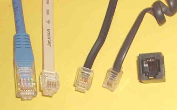

But, early on, the Mac used a RJ11 4P4C connector for the keyboard which is like a phone handset connector but wired differently.

If you're just talking about the connector, then 4P4C. If you're talking about the protocol, then I've seen and used “M0110” after the keyboard model number. Searching for “M0110 protocol” will get you information about it.

Sounds like it's an "unofficial" RJ-type (see "Similar jacks and unofficial names")
So you could use RJ9, RJ10 or RJ22. FWIW, it's definitely the same connector used back in the day for the handset to base on old school (wired) 'phones. :)

I'm a bit late to the party, but I've had luck searching "Mac 128k keyboard" - long winded, but gets me there.
"Mac 4p4c" however, got me back to this post lol.
tinkerBOY calls his adapter "Mac 128k/512k/Plus" for PS2/USB keyboard -> Mac, but M0110 for M0110 to USB.
