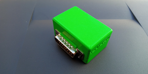

Jockelill
Oh, wünderbar! Can you elaborate on the difference between the "top/bottom" and "tashtwenty_case_top/bottom" STLs?
Yeah, I could have been a bit clearer :). There are actually two versions of the case, one with holes and one without. Each case consists of two parts, a top and a bottom, they are screwed together with countersink 2.5mm 12mm long wood screw.
I have actually modelled the DB19-connector also and succesfully printed that. Same method can also be used to recreate the unobtainable female connector, working on that as well :)
For convinience I've added the two cases in separate zip-files also to this post.

Jockelill
TLDR:
There is a new more compact case.
The longer story:
When trying to connect the TashTwenty to one of our other Macintosh Plus (an upgraded 128k) I realized that it would collide with the mouse connector for this early generation mouse.
So why was the case so wide? Well, I wanted to be able to screw it into the Macintosh, (that was why there was a version with holes through it), and then I just filled those holes in the CAD and kept it wide since it would anyway fit on my other Macintosh Plus with another connector for the mouse (a.k.a "lazy engineering").
But the problem urged me to come up with a solution, so I made some design changes, ditched the screws and it is now not wider than the DB19-connector itself.
Out with the old:
In with the new:
Yeah, I need to clean that connector from dust also :).
