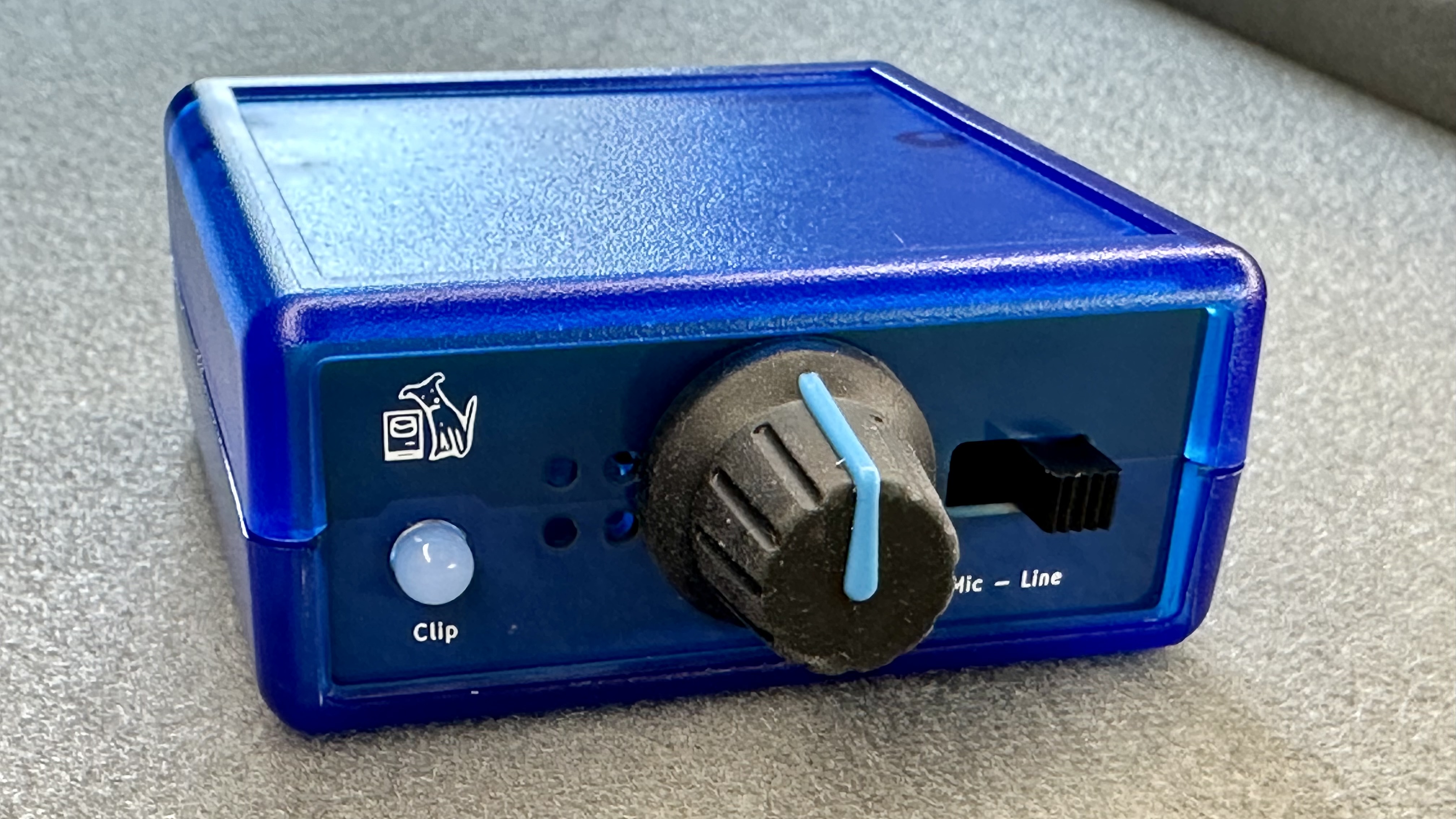

Introducing... TashRecorder!
Elevator Pitch
This a compatible clone of the Farallon MacRecorder , but as far as the software is concerned, it's the real deal!
Both @tashtari and myself (since 2021!) had this project on our own, one of us having a working digital part and the other one some sort of analog part. Project merging happened and TashRecorder was born

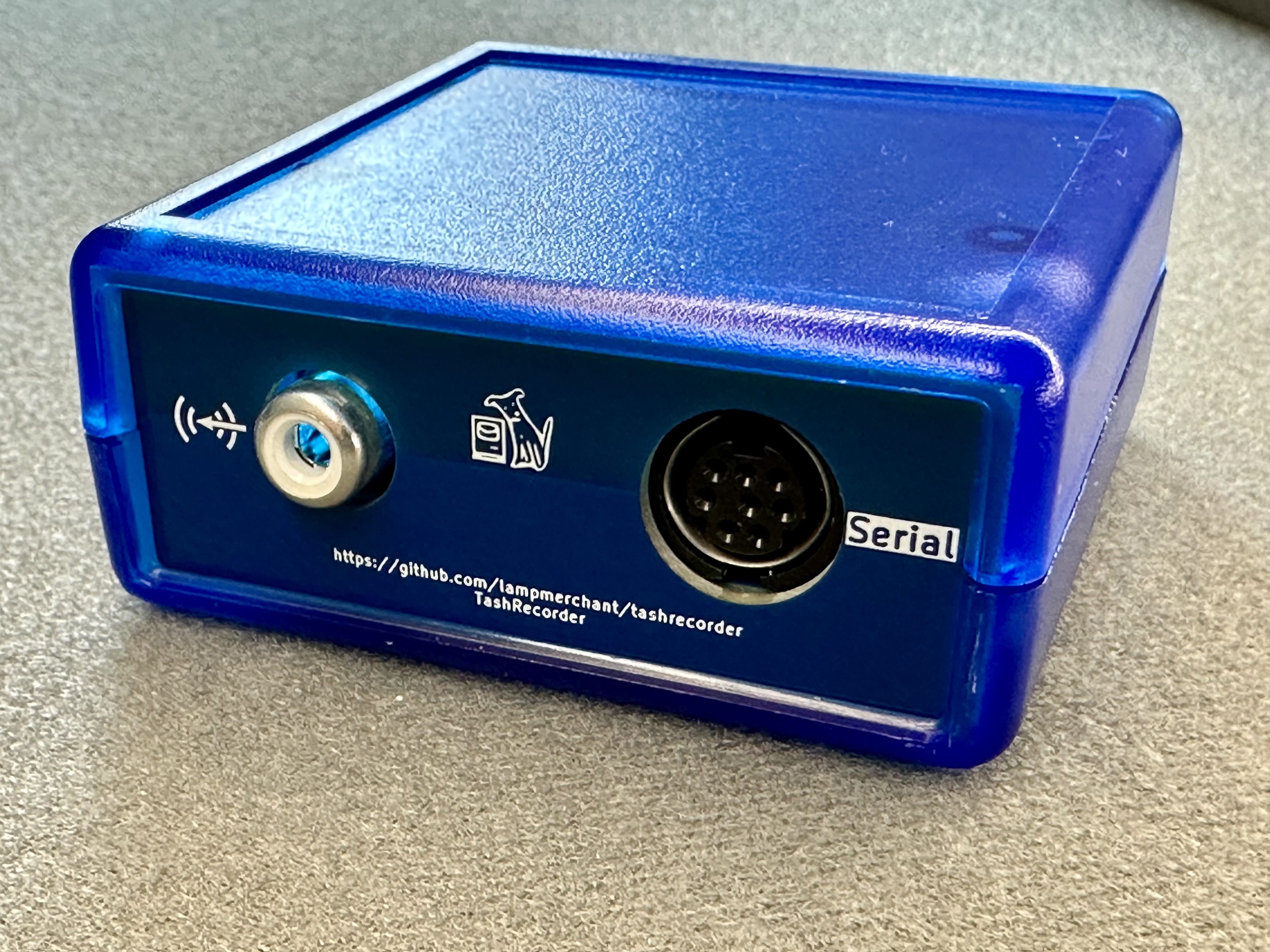

The digital part is made as a PIC12F1501 firmware, the rest is made as a 4 layer PCB and, as usual, panels to make it fit neatly into the same case as Quack, TashPad and TashTwenty

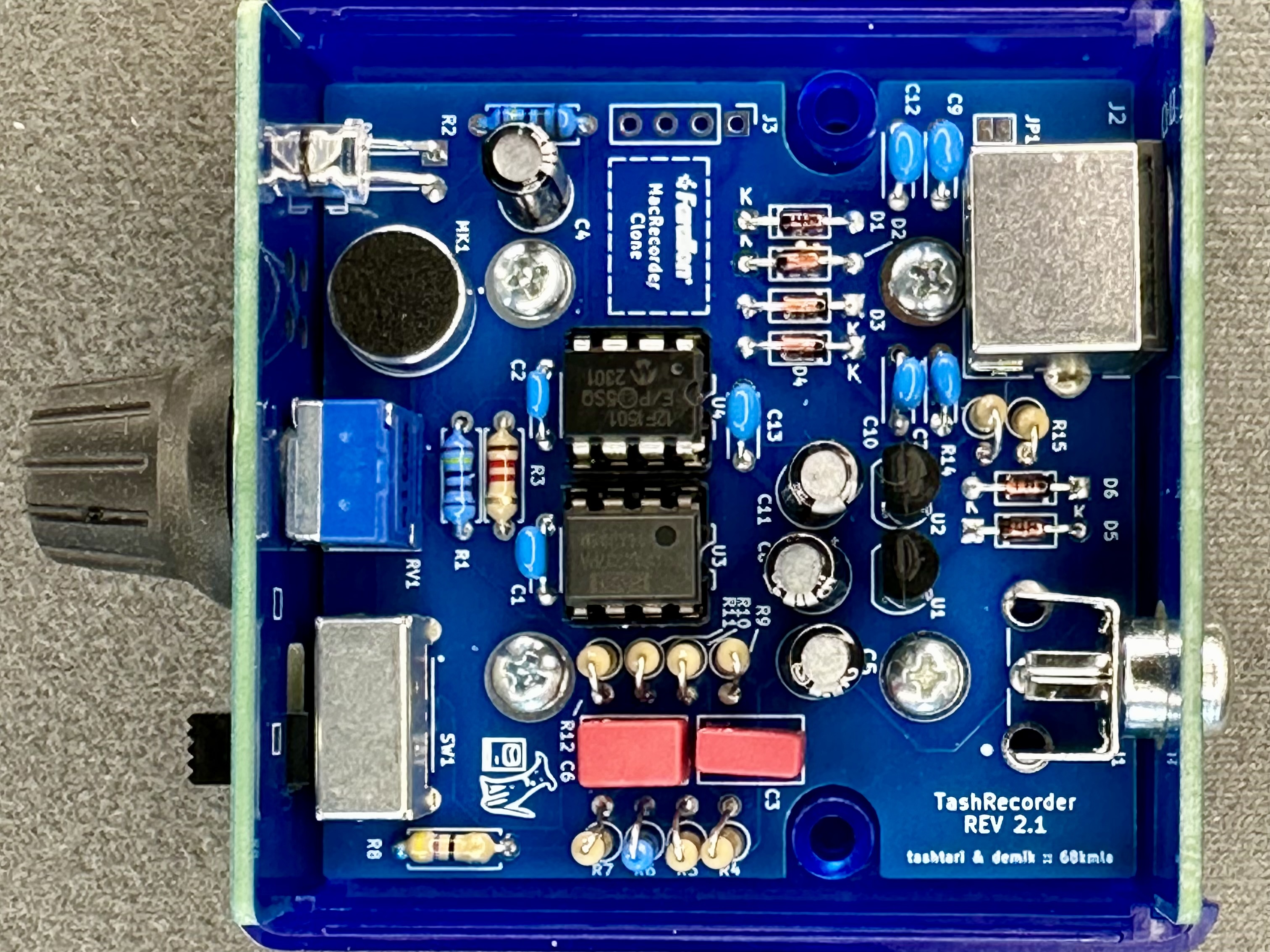

This clone, like the other ones, includes an internal microphone and mono line input. We tried to simplify the design as much as possible, to allow it to be built more easily. The design is all through hole components, using only available components
While the PIC is acting as a serial transceiver, ADC and clock generator, it also oversample audio and watch input levels, driving a LED mimicking if the input levels are too high (or you are screaming too much)
The analog part is built around a much more modern CMOS Burr-Brown amp, which act as a microphone amplifier, band pass (microphone) or low pass filter (line in), and is optimised for battery and low power devices.
Kind reminder that the MacRecorder is only powered by the serial port, no external power is needed! TashRecorder includes its own power regulator circuit
