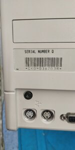

I found a Mac SE/30, it looked just a normal SE/30 but when I decoded the serial number in http://macfaq.org/serial.html
I got this:
Your German Macintosh SE 1/40 (03R), with serial number CK0403A203R
Trying with http://myoldmac.net/FAQ/Mac-Serialnumber-decoder-e.php I got:
Manufactured in: CK => Cork, Ireland
Year of production: 1990
Week of production: 40
Production number: 3A2 => 3810
Model ID: 03R => unknown Mac
SE 1/40?? what is this?
German? The case itself and the MB to me are simply international. Is it?
My other SE/30 decoded just righta as
Model ID: KH1 => Macintosh SE/30
Any idea?

That is an odd serial number. I can only speculate: maybe it's the first of the International SE/30 models sold? Maybe the first of that model built in Cork? Maybe a unique configuration or customer?
Otherwise, SE 1/40 just means an SE with 1MB RAM and a 40MB HD. Pretty typical configuration for an SE.
Maybe that site thinks "international" means "German."
At least the model marked "SE 1/20" on the front was only sold in some places. Mine certainly came from Germany. I don't know if there was a model marked 1/40 on the front or where it was sold. But it's not as simple, even at that point, as "US" vs "everywhere else".

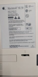

I'm guessing this machine might have been upgraded with a new LB, front panel and back sticker. I wonder if the old SE sticker is still underneath it.

The 1/40 was an SE with 1MB RAM and a 40MB hard drive, sold in some markets and the silkscreen on the front would indeed say 1/40.

Collecting all the questions:
I do not have other parts, I got it simply it with the case, mouse and keyboard (ITA).
The large label on the back is not on top of another one. This is quite different respect the one of the "normal" one
The internal code of the case is the same of my other SE/30 "815-0960", the factory is the same "Tohoku Munekata co Ltd.", Fukusima. Fukusima??? Ah .. ok.

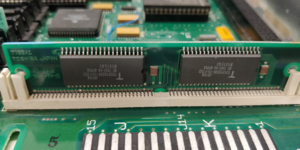

The board is 820-0260 rev A 1989, the other "normal" SE/30 is rev 10
The ROM in the SIMM of the weird one are rectangular and not squared, apologies I can not name them properly..
See the pics below. do not consider the caps and absence of the battery, the "weird" one suffered a battery bombing but it survived.
The blue bodge wire is a fix for a broken trace.
It's funny that the non German version (assuming that it has something to do with Germany) has a german statement in the label :D

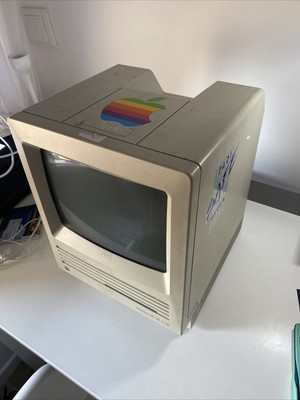

I found one
the last three digits of the serial number is 03R, as in my case, but my label says SE/30, it was probably an upgrade, the case was kept and the label replaced. The entire front part was replaced as well. Was this an Apple official upgrade?
