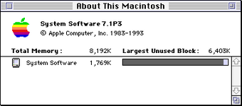

I recently bought a Performa 410, and found a couple of cool things on it.
First of all, it's running System 7.1P3 and has barely been customized. All of the original software is there and nothing new was added except for a few fonts. The machine appears to have only been used for ClarisWorks. That's exciting because 7.1P3 is a version that hasn't actually been preserved by anyone yet. I'm going to clean it up a tad bit more to get it totally back to stock state and then run Apple Backup and share it so that we have a clean reference install of 7.1P3.
