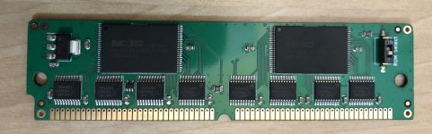

Good news! The 8MB SIMM works!
Thanks to all of the testers for their diligent work on the 2 MB SIMM! @JDW uncovered a significant defect in the 2 MB SIMM which is possibly the reason it didn’t work in his SE/30. Fortunately the 8 MB SIMM doesn’t have this issue, so hopefully that will fix the incompatibility with his machine.
So 8 MB SIMMs are going out to testers soon!
If the 8 MB SIMM testing goes better than the 2 MB testing (which went okay from a software perspective, but there were too many mechanical issues in SE/30s), we will be able to finalize the disk images and the release plan.
@ZaneKaminski, I sent you some PM's a week ago, giving you a detailed compatibility report regarding the 8MB ROM you kindly shipped to me for testing.  I haven't yet received a reply back from you so I thought I'd flag you about my PM's here.  Not sure if you are busy or if this forum's email notifications are down again.

While testing Zane's 8MB ROM, as I reported to him via PM, my MacCon Ethernet PDS card works just fine with his ROM, even when my MacCon is stacked atop my DiiMO PDS accelerator card.
I am able to boot just fine with my 50MHz DiiMO PDS accelerator card (68030) installed, either from a SCSI hard disk or the FloppyEMU (using either a virtual floppy or HD20 mode) or from a real floppy disk.  I can format real floppy disks and duplicate disks just fine.
The bad news is that the motherboard-socketed Daystar PowerCache 50MHz 68030 accelerator board is NOT compatible with the 8MB ROM, as per the fact it yields the following screen on my SE/30.
But on a more positive note, I am able to boot my SE/30 just fine with my DayStar Turbo040 40MHz PDS accelerator card (with TS Adapter) installed (which I cannot do with the ROM-inator II unless I use the OlePigeon patched ROM), but the 8MB ROM only works fine from a SCSI hard disk or FloppyEMU virtual floppy disk (400K or 800K only).  HD20 Mode on the FloppyEMU does NOT work with the Turbo040 and Zane's 8MB ROM installed.  Also, 1.44MB disks, whether real floppy disks in the internal drive or 1.44MB disk images on the FloppyEMU do NOT work at all, whether I try to boot from them or simply try to mount them on the desktop when booted.  If I boot from a SCSI hard disk and insert a 1.44MB floppy, it asks me to initialize it.  But again, 400K and 800K disks work fine.  If I remove the Turbo040 and TS Adapter, then I can read/write 1.44MB floppy disks again.  This seems to be a bug with the 8MB ROM and the Turbo040 for SE/30.
What was the mechanical issue, the thickness of the ROM SIMM?
I ended up swapping the socket on a couple of my logic boards (somewhat invasive but worth it to me) and made a video on how to do it:

That's been on my mind too. I hope all is well. I tested the 2MB SIMM and it worked well for me.
I just don't understand how some of you get the 2MB ROM to work.  I tried everything, including multiple motherboards.  I even added solder to each pad on the ROM SIMM.  Nothing -- I mean NOTHING -- worked.  Then Zane shipped me the 8MB version and it worked just fine on the first try.  I know it's not the content of the 2MB ROM because I have a ROM-inator II programmer and verified the ROM content that way.
I wouldn't worry about it. Appears to be related to any individual machines connector. I can't get the 8MB SIMM to boot without applying finger/thumb pressure in my test setup, which is just about the same result I get with the original @dougg3 LED pirate SIMM and Rominator in my SE/30. I'm sure a fix is in the works, so just stop fiddling with fixing a well documented bug before you break a connector! [;)]
