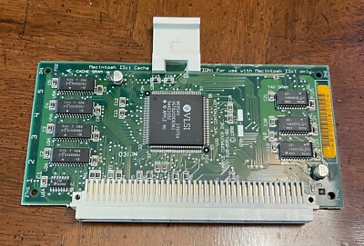

Makes me wonder what I did with the OEM cache cards in my IIci's that have Daystars in them now.
How hard would it be to make a few 1-2MB cache cards? I assume the connector would be the most expensive part.

trag
Cost of 5V static RAM adds up to a bit, I think. But really, the most "expensive" part is the skull sweat to figure out how to build the cache supporting circuitry. Although I think Zane Kaminsky may have already done the basic analysis. I seem to remember him discussing potential performance of IIci and some issues regarding playing with the 68030 bus and the necessary timings.
If one uses real TAG RAM instead of building it out of Static RAM + Fast Comparator, that gets pricey too. TAG RAM is getting close to unobtainium
Euro-DIN (a.k.a. DIN 41612) connectors used by Apple during the 68000-68030 era still widely available, even if they are not cheap in small quantity. The 120-pins version for PDS is probably that one on Mouser; NuBus (and the LC PDS I think) uses the 96-pins version (NuBusFPGA uses that one).
Probably. I've added a TI reference in a previous message; the description of the 2155 is also available in the 1990 TI Cache Memory Management Data Book. There's also a working implementation (with some features missing such as burst mode) as the cache part of German magazine C'T accelerator, the PAK68/3. The relevant articles and bit of PAL code were posted on TD.
Edit: BTW it's not just TI; e.g. IDT has an application note on the subject in the 1991 Static RAM Data Book, also for their custom cache chips.
Edit 2: in fact the IDT stuff seems more complete than the TI stuff - there's even some PAL equation for their version of a cache.

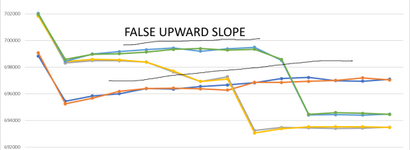

I've upgraded my cache detection algorithm to eliminate the loop bias that resulted in an upward sloping artifact.
Now, there is an inner loop that tests 256 bytes at a time, and an outer loop that repeats that for a total of 32K reads and then checks if 1 second has passed. The buffer pointer just rolls over to the start of the buffer when it needs to. Thus, all sizes of cache testing now have nearly identical overhead. Previously, larger cache checks were artificially more efficient as the inner loop went the full buffer size (rather than consistently 256 bytes) before dropping to the outer loop.
Test conditions: System 7.5.5. 20 MB RAM (4 MB bank A, 16 MB bank B). Disk cache 128KB. Tests run on external MacSD. 640x480 8-bit color. Appletalk off. Pictured top to bottom: Apple Macintosh IIci Cache Card 820-0351-A (32KB), ATTO Technology Cache C1 (64KB), DayStar FastCache IIci (32KB), Micron Technology Xceed IIci-128 250-0324-010 Rev C (128KB).
The new test results are below. There are 4 cards + stock being tested, each twice. But it looks like 5 only lines, because the runs for each setup are so consistent that the lines for each run nearly completely overlap on the graph. The lack of significant variation in each run suggests the differences between each card are real and not noise.
Ⓐ The 256 byte cache built-in to the 68030 processor is the most efficient, thus every run starts out high. The Y-axis indicates that the 25 MHz IIci is achieving 1.36 million memory reads per second.
Ⓑ All the external caches gradually become less efficient as the test buffer size fills more and more of the cache, thus competing more with code, system, and other usages. Still, size and brand impacts the rate of decline.
Ⓒ When the test buffer size exceeds the external cache size, overall efficiency drops below stock (no cache) performance. The sudden drop is due to the test being a linear read rather than random. In other words, in these conditions, the test loop is constantly asking for a non-cached value, which is then cached, but dropped (due to all the subsequent reads) from the cache before we try reading it again. These are constant cache misses.
Miss efficiency is worse than hit efficiency, such that memory intensive applications could theoretically run slower with a cache card. In practice, the fact that loops and common subroutines will be cached and repeatedly hit means real world performance will likely always be better with a cache card. This test is designed to detect cache sizes, not application performance..
