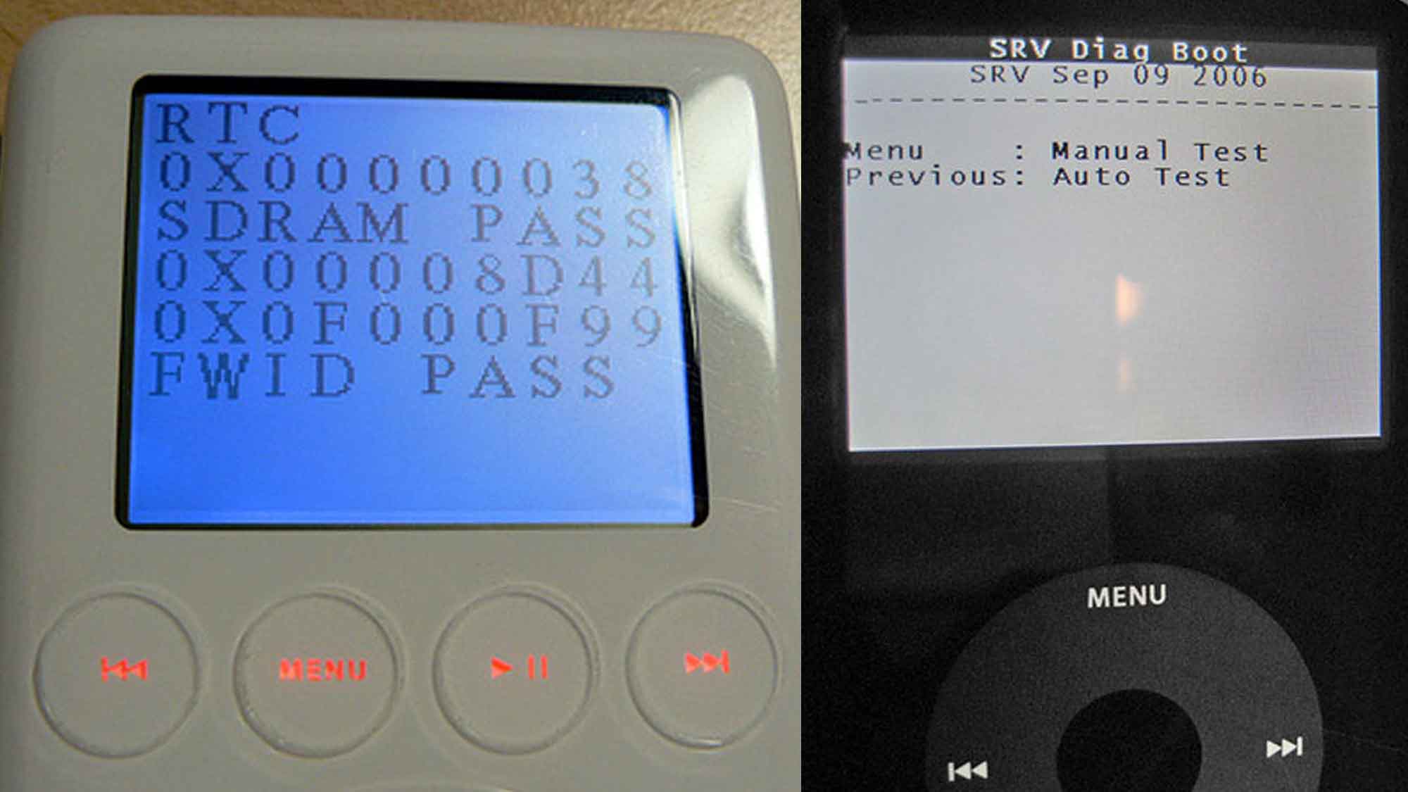

EDIT: got into internal diagnostic mode, and all checks out:

Have you tried various FW cables?
Yes, I've come across a couple of dud FW cables over the years. I've a Lacie and thicker generic FW cable and both work on an external HD, I don't have the Apple branded FW to FW but surely not?
