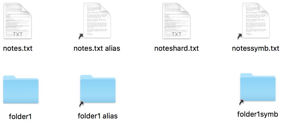

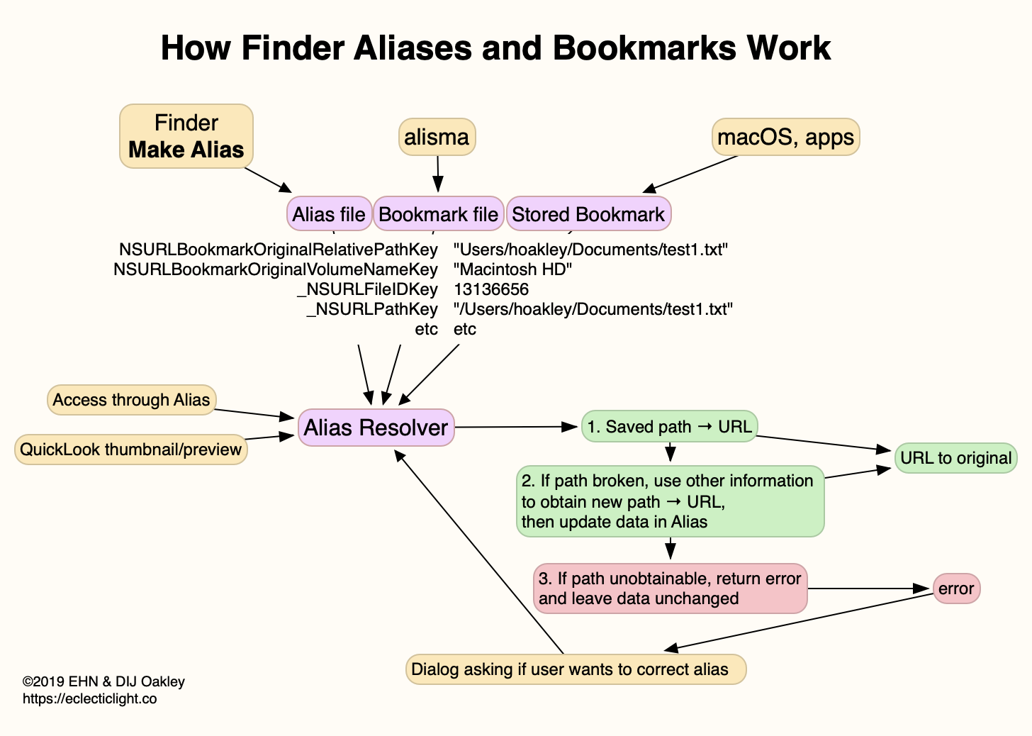

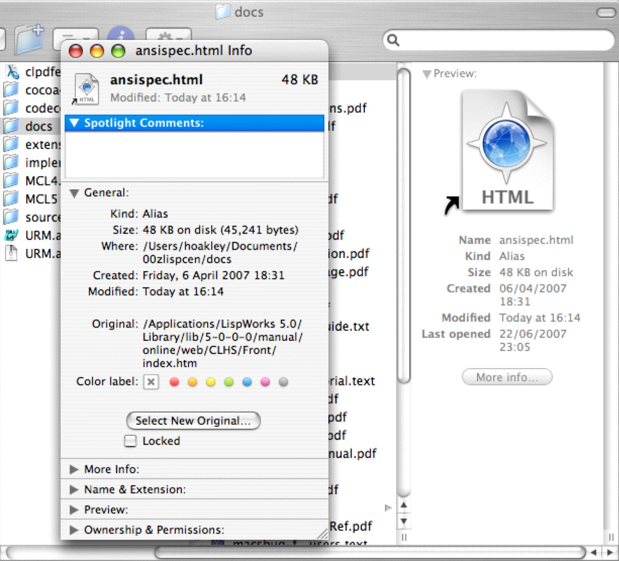

I need, in the future, to keep track of a few directories, and I've read somewhere that we do that by creating aliases. I have no idea how that works, but I imagine an alias will keep a reference to the directory in disc? As long as I can retrieve it, I think it will be safe even if it WD number changes.
