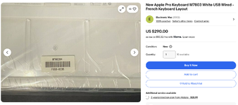

Interestingly, here is a French White M7803 with 'F 658-0235' on it!
Like Chris said, thanks for sharing your collection with us in such detail, really beautiful (and helpful)
Thanks for the kind words. Interesting - so 658-0235 is definitely the keyboard then; who knows what the remaining 602-5222 is.
