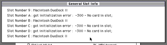

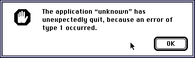

I have an error 1 with slots grab on the Duo Dock II. It works with another Mac.
What slot is the card in? You can try running Code Warrior Pro 4 to debug it.
What does slotrom-1.0.4 show in the dbglog?

There is no card on the Duo Dock II, only the dock itself.
I join the debug log and capture from slot info

joevt
I can't debug the problem without information from a debugger.
But I can make a change to let you enter a specific slot to look at which might skip the problem?
Download v1.3. Run SlotsGrab and enter E at the prompt to only dump Slot E.
Dandu
I have the same error withe the "E" slot
I can launch the debugger and made the things you will, but 'im not an expert : do you have a list of things to do ?

Install CodeWarrior Pro 4 and its MetroNub extension. Fix the cinttypes header as described in one of the source files. Build the SlotsGrab target. Debug the target from the IDE. Where does it stop? What error does it report?
