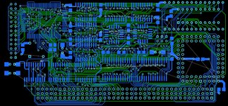

Here's what the current progress on the board itself looks like:

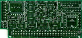

Along with the original scan:
There's a lot more going on in the inner layers than I anticipated, so it's going to take a bit to get it fully complete, but I should be able to at least get all the GAL connections mapped out.
