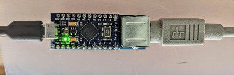

I just put one of these converters together -it's great, and far more convenient than cramming the Arduino inside the keyboard itself!
Using the online QMK configuration tool, I made a custom QMK firmware that allows the F10-12 keys to act as either function keys or volume controls depending on whether or not I hold down a modifier key. It is nice to finally have working caps lock and volume keys again after years of using the Griffin iMate converter.
Thanks to @ronan for designing a PCB to make this easier, and to @Skate323k137 for sending me the parts I needed to make one.
