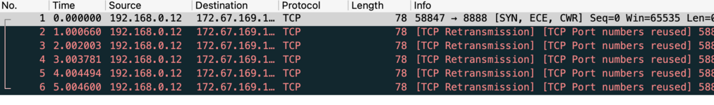

Yes, going through your cloudflare setup, I don't even get an ACK back from the SE/30:

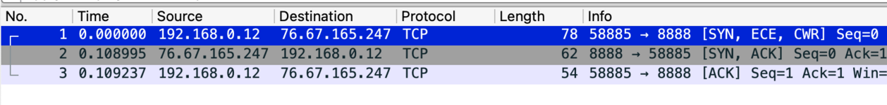

Whereas I do get an ACK back immediately when short-circuiting it via the direct IP:

This almost certainly isn't a DNS problem (at least not straightforwardly) - definitely look at your cloudflare setup.

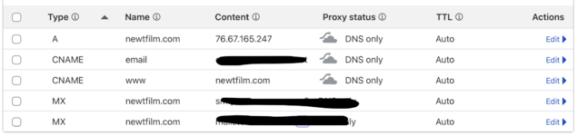

I used another one of my domain names, http://newtfilm.com:8888 and in cloudflare I put it in development mode (supposed to bypass cloudflare's servers). Here's a photo of my DNS settings:

I'm sure there is something about setting up DNS I've either forgotten or never understood, and I suspect it's on the virtual hosts page, unless you can see something wrong with Cloudflare's setup.
