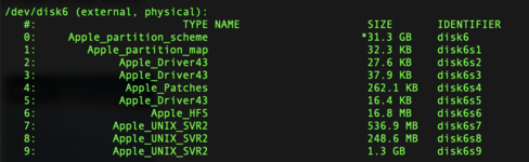

So, I am trying the SCSI2SD approach again. I flashed it onto the SCSISD again, put it into the Quadra and booted from the Silverlining floppy. Now the strangest thing happens which might explain why it is not working... I see 3 SCSI IDs while only 2 are configured on the SCSI2SD. Verified using different boards...
Anybody see this before? The 3 SCSI disks are all invalid according to Silverlining and it is unable to repair. When I check the disk in my Mac I can display the partition table without issues.

I found that if I unchecked "Enable Unit Attention" and "Disable glitch filter" it started working. On my other SCSI2SD card with the install I did from scratch those are both checked.
Probably you already tried this, but if not; maybe worth trying.
